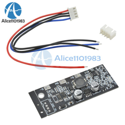

For the BMS, I'll be using this one I've seen mentioned on the forums:
If I'm understanding, I should be able to use any old power supply as long as it's between the input voltage range specified on the board (9v-18v), correct? I don't need a smart charger? I know this is all in the guide and I'm probably being annoyingly cautious, but I'm very concerned with battery safety and want to make sure I get this right before I wire everything up since I haven't done this before. Thanks in advance.

You are correct, the "Red Board" BMS (they used to be red) will accept any dumb input voltage within its advertised range to charge the cells. I have personally used a 9V3A supply with an older revision of it and it worked great. Just be aware that the max charging rate of that BMS is only 1 Amp, so it will take around 8-10 hours to charge 4 of those cells.
It also has a safety feature where you are required to connect a charging current after first connecting the cells to enable output from the BMS. This only needs to be done when cells are disconnected or added to the BMS.
